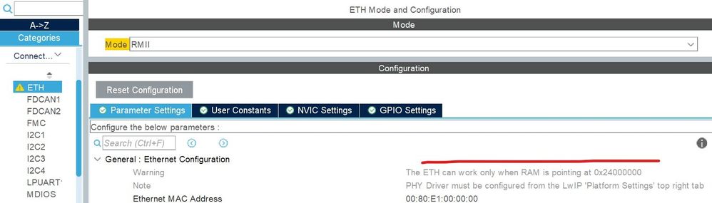

Hello.. i m working on Ethernet RMII on H743 nucleo, and encountered this error msg, could anyone advise how to configure RAM at 0x24000000? TQ!

The linker file (*.ld) in the directory of the generated code describes what memory is used for RAM. Probably it's pointing to 0x24000000 by default, as opposed to DTCMRAM or somewhere the DMA can't reach.

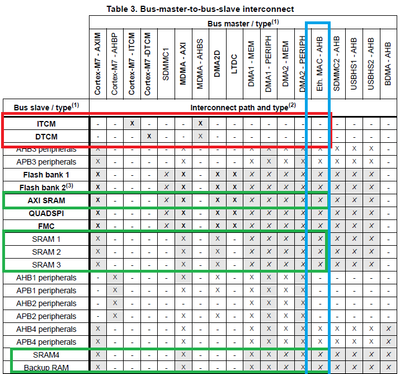

I think the warning should be "The ETH can work only when RAM is not pointing to the DTCM-RAM" because ETH has no access to the DTCM nor ITCM.
So forget about that warning and just place your descriptors in SRAM_D2 for example (SRAM1, SRAM2, SRAM3). You can follow this article.
I will escalate that internally for modification and get back to you for any feedback. Internal ticket number 204183 not accessible by the community users.

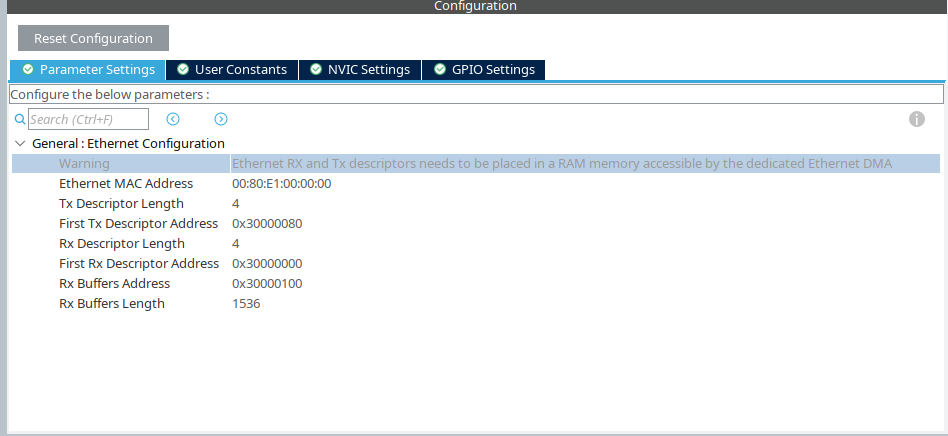

Or simply say:
"Ethernet RX and Tx descriptors needs to be placed in a RAM memory accessible by the dedicated Ethernet DMA"
