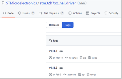

../Core/Src/USB/stm32h7xx_ll_usb.c:2175:19: error: conflicting types for 'USB_DeActivateRemoteWakeup'; have 'HAL_StatusTypeDef(USB_OTG_GlobalTypeDef *)'I looked at the code for version v1.11.3 on github and it looks like it is fixed, but that version hasn't been released yet. So when can we expect a fix?

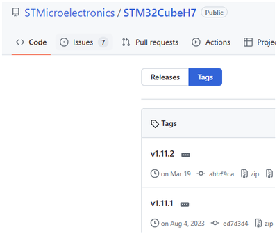

2024-05-14 9:12 AM - edited 2024-05-14 9:16 AM
@unsigned_char_array There's mismatch between versions of H7 HAL drivers repo and the "jumbo package".
As you can see on github, the jumbo pack 1.11.2 of Mar, 11 contains HAL drivers 1.11.3
STM32CubeH7 jumbo package 1.11.3 is not available on github yet.
You're not the 1st person confused by this ))

The github H7 version v1.11.3 was released on 2024-03-19 while STM32CubeMX 6.11.1 was released on 2024-04-25. So why wasn't that version included in that version? When can I expect that release?
