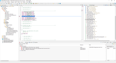

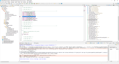

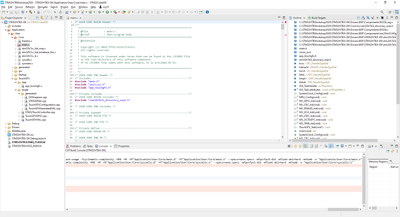

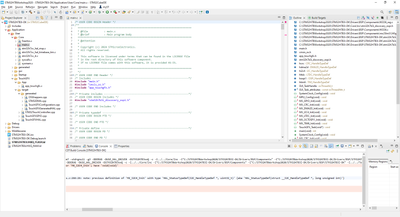

main.c:76:13: error: conflicting types for 'MX_I2C4_Init'; have 'void(void)'
2.
BSP/STM32H7B3I-DK/stm32h7b3i_discovery_bus.c:266:26: note: previous definition of 'MX_I2C4_Init' with type 'HAL_StatusTypeDef(I2C_HandleTypeDef *, uint32_t)' {aka 'HAL_StatusTypeDef(struct __I2C_HandleTypeDef *, long unsigned int)'}
266 | __weak HAL_StatusTypeDef MX_I2C4_Init(I2C_HandleTypeDef *hI2c, uint32_t timing)
Please refer to attached screenshots:
Thank you very much for your attention and support. Please advise at your earliest convenience.

2024-12-02 10:52 PM
Hello @EY1 and welcome to the ST Community.
Have you tried using the STM32CubeMX V6.13.0, STM32CubeIDE V1.17.0 and the STM32CubeH7 V1.12.0. If the issue persists, please upload the project that reproduce this issue here.
Best Regards.
STTwo-32
2024-12-10 9:50 PM
Dear STTwo-32,
Thank you very much for your reply.
I have updated the software, and now using the STM32CubeMX V6.13.0, STM32CubeIDE V1.17.0 and the STM32CubeH7 V1.12.0.
So far, do not see the build errors asked before; thank you!
But having the following new build errors, and do not know what to do:
(Copy from the Console of STM32CubeIDE after build)
In file included from C:/STM32H7BWorkshop2020/STM32H7B3I-DK/Drivers/BSP/STM32H7B3I-DK/stm32h7b3i_discovery_ts.c:51,
from <command-line>:
../../Core/Inc/stm32h7b3i_discovery_ts.h:73:37: error: expected unqualified-id before numeric constant
73 | #define TS_I2C_ADDRESS 0x70U
../../TouchGFX/target/STM32TouchController.hpp:67:27: note: in expansion of macro 'TS_I2C_ADDRESS'
67 | static const uint16_t TS_I2C_ADDRESS = ((uint16_t)0x70);
make: *** [Application/User/TouchGFX/target/generated/subdir.mk:32: Application/User/TouchGFX/target/generated/TouchGFXConfiguration.o] Error 1
make: *** Waiting for unfinished jobs....
"make -j2 all" terminated with exit code 2. Build might be incomplete.
14:13:49 Build Failed. 3 errors, 0 warnings. (took 1m:33s.39ms)
(End of Copy from the Console)
Could you please advise what to do?
