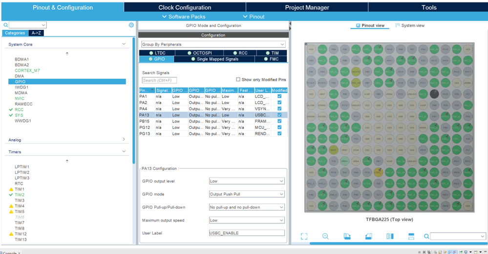

I am trying to understand how to configure a custom GPIO pin via the CubeMX/CubeIDE. I am using the STM32H7B3I-EVAL. Through the CubeMX, I am trying to assign PA13 to a GPIO (in output mode). I enabled PA13 via the CubeMX without issue.

Read The Fine Manual (and the Datasheet) (and the board's manual). PA13 & PA14 are SWDIO pins, used for programming and debugging. Other than that, you may use any pin you want as long as its use does not conflict with its connection on the board you have..
2022-11-07 11:31 AM
Believe me, you don't want to assign PA13 as g.p. output - it's the debug interface pin.
And GPIO_PIN_13 is simply the bit mask of any port's line no. 13. It has nothing to do with physical pin numbering. So PA15 will be GPIO_PIN_15

In the CubeMX view, it has many of hte pins greyed out. That would mean they're not being used, correct? So if I use one of those greyed out pins, it should not affect any other functionality, correct?
2022-11-07 12:06 PM
I think it means they are not in use by the peripherals you have currently enabled in the project.
I don't think it means they are not physically committed to some other functionality via the wiring on the board.
Expect close to 98% commitment of all pins to other functionality on the EVAL board.
How egregious those conflicts are depends on what/how those pins are connected too. Have your HW engineer review the board level design.
The EVAL boards are NOT good break-out boards. They are KITCHEN SINK boards where ST has built about every piece of functionality it can demonstrate into a single board. So Screens, SDRAM, Parallel NOR Flash, Serial NOR Flash, Ethernet, Serial, CAN, CAMERA, etc.
