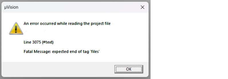

When I try to open the project it shows the following message:

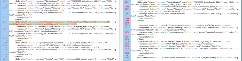

Comparing the project files shows that the following section gets removed:
Manually adding this section back solves the problem temporarily until the next code generation is done.
