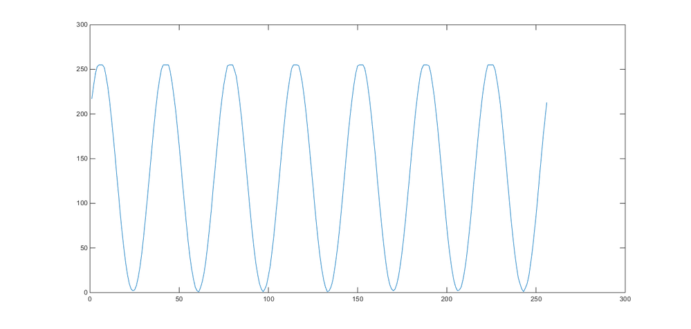

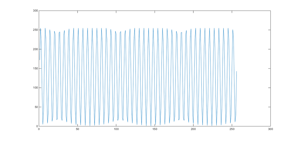

I have change sample cycle from 480 to 28. it works very well till frequency of 1KHz. Above that it start to degrade. I change ADC clock in order to make higher sample rate but it fails, even decreasing ADC clock make it worse!
Approximately the sample rate is :(ADC prescaler=8 and prescaler peripheral clock=2)sample rate= 168MHz/(2*8*28)=375 KHz1KHz inputI thought this is the way of doing that. DMA interrupt for each ADC transfer and UART send with higher transfer rate than sampling rate. I set DMA is mode 1. you suggest that I use DMA in mode2?can you give more insights? or maybe a code example.
