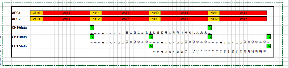

I test it for single channel continues conversion mode and it works. But for dual mode, it is mystery. This is very sad that STM release new Library without enough supports or examples! I am going to migrate back to old standard library. I just waste my whole time. Now I have to begin from start point with old Std library.

For better modification I did this changes. But It doesn't work properly. The problem is that only channel 12 data shown correctly and channel 11 data is missed!! There is something with DMA I assume.
>Change DMA buffer size from 4 to 2
>Change variable aADCDualConvertedValue[4] toaADCDualConvertedValue[2]
>Turn off scan mode
>ChangeADC_InitStructure.ADC_NbrOfConversion = 2 to 1
>Remove second channels in each ADC config
