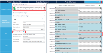

I think I found a solution to also choose the desired RAM in CubeMX. This has been added in CubeMX v6.13.
To do this, navigate to Tools > Memory Management, where you can select the type of RAM you want to use.
Make sure to enable the following options:
- "Apply Application Regions to Peripherals"
- "Apply Application Regions to Linker Files"
- and check the "Default Data Region" box.
Also, ensure that you delete the existing .ld file in your project folder. Otherwise, the .ld file will not be updated.
I have highlighted the important steps for your attention in the figure below:
