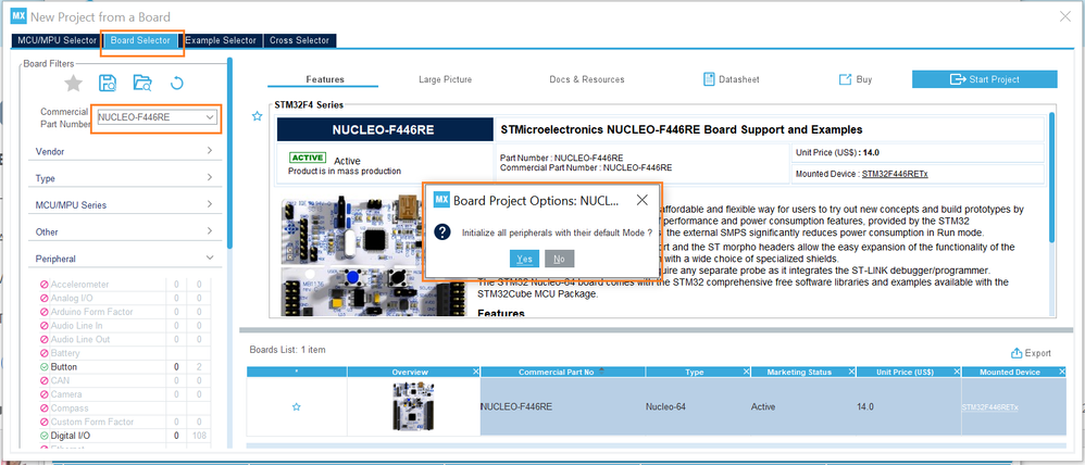

Thanks for your feedback. Normally when selecting a board through Board Selector tab, a dialog window requesting to initialize all peripherals to their default mode will be displayed.
Selecting the NUCLEO-F446RE board to start a project, the initialization message will be correctly displayed:
Please make sure that you switch to Board Selector tab , and select the NUCLEO-F446RE board (with the mounted STM32F446RETx MCU).

2021-03-11 4:36 AM
Thank you for the reply
Have observed problem in the repository folder, after upgrading to the new version, old repository also need to be replaced. otherwise will never show the pop-up initialization message.
