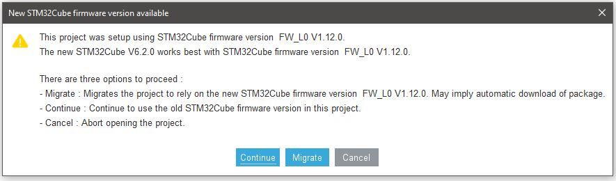

Thanks for your reply. The problem with the line LL_ADC_EnableInternalRegulator(ADC1) is solved in the latest firmware FW_L0 V1.12.0 .
I noticed that after re-opening the .ioc file STM32CubeMX wanted to upgrade. After letting it do that, it now produces the correct code.
Odd though, is that I do not see that it does upgrade the firmware, see picture.

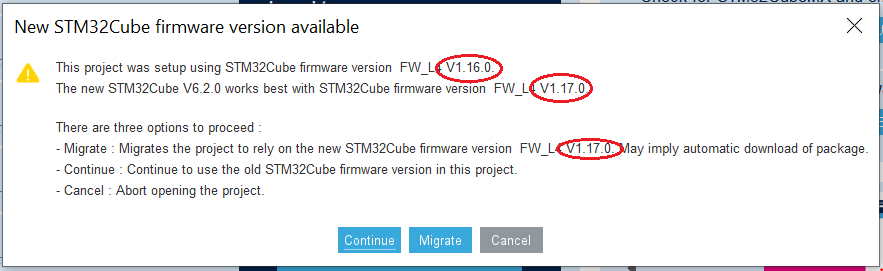

To explain briefly the message behind this warning popup: On project load, STM32CubeMX detects if the project was created with an older version of the tool and if this is the case, it proposes the user to either migrate to use the latest STM32CubeMX database and STM32Cube firmware version, or to continue.
You can select continue to use original firmware used at project creation and in this case it will downloaded into your repository as well as the MCU and IPs database, or you can select migrate, and in this case your project will be modified to fit the current database definition.
It is a bit odd that this warning window is displayed while working with latest version of firmware. The expected behavior is as in the picture attached below (two different versions of firmware):
Could please describe how did you reproduce to get this pop up? It will be really helpful for us to track the root cause of this misbehavior.

Hello Khouloud,
To reproduce the pop-up I just have to double-click the .ioc file, after having upgraded STM32CubeMX to the latest firmware.
Maybe a little background on how I use STM32CubeMX and STM32CubeIDE might help...
  • I create a new project with STM32CubeIDE in the usual way.
  • After having created the project and its code I never open the .ioc file in that folder again.
  • This is because I have been bitten a few times by STM32CubeMX and STM32CubeIDE when I did reopen the .ioc file to change someting and it deleted all my edits.
  • Yes, I know how to prevent that, by placing my code in the correct places (between the comment lines) but it STILL deleted my code.
  • So now I have the routine to create the project with STM32CubeIDE and then immediately move the .ioc file to another (sandbox) folder.
  • If I want to make changes to it, I start STM32CubeMX in this sandbox folder, make the changes, and manually copy the code to the actual project. It is a bit more work, but this way I have never lost my code again.
I'll add the not migrated .ioc file to this message, you will no doubt have the FW-L0 V1.12.0 loaded, so just doubleclick the .ioc file and the pop-up (hopefully) will appear.
