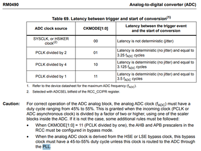

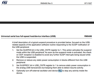

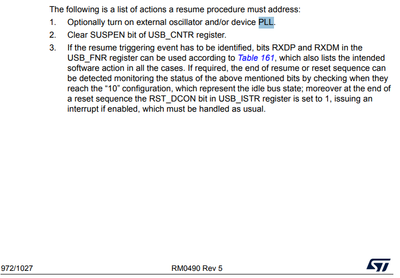

@Andrew Neil wrote:There is no mention in the Datasheet
however, there are three mentions in the Reference Manual:
via: https://www.st.com/en/microcontrollers-microprocessors/stm32c071cb.html#documentation
@STTwo-32 These look like copy-paste errors in the RM ?

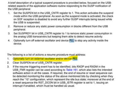

Thank you for your quick response. I was reviewing the user manual and came across a statement that says, "Optionally turn ON external Oscillator and/or device PLL." This wording left me a bit confused, so I just wanted to confirm whether the PLL can actually be used in this case.

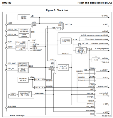

As noted earlier, those look like copy-&-paste errors - and @STTwo-32 is looking into it.
If the PLL existed, it would be documented in the RM, and would appear in the Clock Tree:
