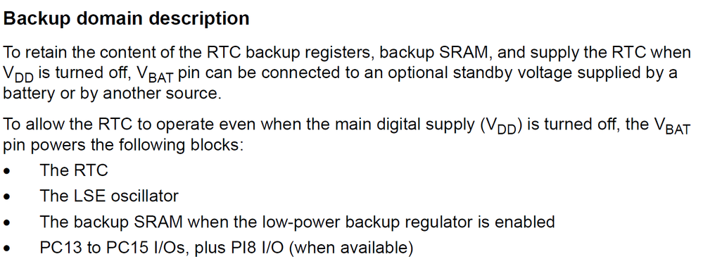

2021-08-27 12:01 PM
Backup registers are in SRAM and are erased when power is lost. VBAT supplies power to them, so the typical way to retain them is to attach a battery to VBAT to keep it powered when your main source of power is gone.
From the RM:
2021-08-27 12:01 PM
From the RM:
