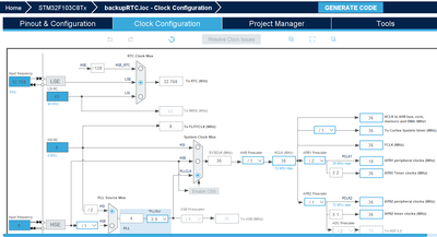

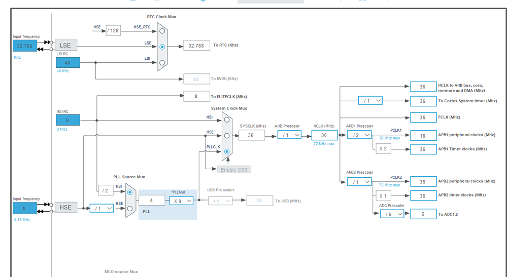

We also try with LSE but clock not getting updated please reslove the issue.you can check below clock configuration
