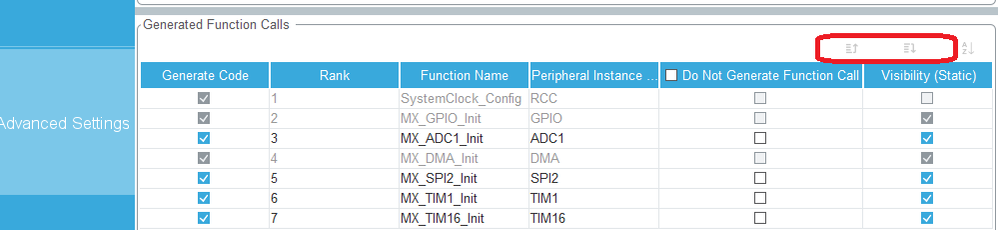

(CubeMX v6.5)
Why is my USB Virtual Com Port UART (UART3) initialization order entry grayed-out?
(For that matter, why is the DMA init grayed out, and prevented from being moved?)
This prevents a user fix by moving the DMA init to the top!
2022-03-26 5:01 AM
> Unfortunately, the bug persists in version 6.5
Are you talking about a project started freshly in v6.5? If you migrated projects started in older versions, see last link in the initial post for the official method to fix.
I don't know, but you may want to start a thread describing exactly what you've done and what are the symptoms, to allow the Cube crew to reproduce the problem and react adequately.
Generally, if the problems using Cube/CubeMX outweigh benefits from its usage, you may consider using other, traditional methods of programming STM32.
2022-04-13 1:46 PM
Please Please Please activate below icons:pensive_face:

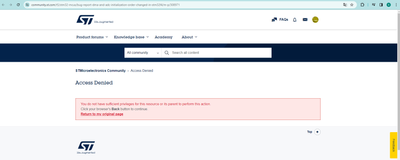

Hi, I'm new here, could someone please explain why can't I open some issue pages?
Thank you in advance.
2024-03-27 8:47 AM - edited 2024-03-27 8:47 AM
This forum underwent migration to a different software, and some threads did not get migrated correctly. ST may fix this in the future.
I'm not sure you need to see that particular thread, though; they all were related to the same underlying problem, as discussed further in this thread.
