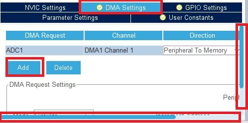

2020-10-08 2:40 AM
You can change the DMA data width in 'ioc' file or 'stm32f3xx_hal_msp.c' file.
In my case is use DMA for record ADC value. But now am i explain how change data width. So i think not many difference.
1.Change in .ioc file
I think maybe you aleady added DMA request .
After add DMA and click that request.
Then you got 'DMA Reques Setting' menu and 'scroll bar'.
Now you can change DMA working mode and data width.
2.Change 'stm32f3xx_hal_msp.c'
It maybe little diffrence because my DMAhandle name is 'hdma_adc1' and your DMAhandle name is maybe 'hdma_uartx?' anyway.
DMA init is occured in 'HAL_ADC_MspInit' function.
So if you change the data width of the code below, you can get the desired result.

2020-10-08 2:44 AM
Oh! I have mistake.
Maybe you must find 'HAL_UART_MspInit' function In second method.
