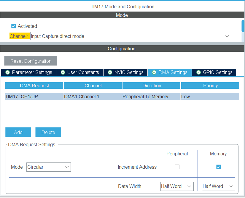

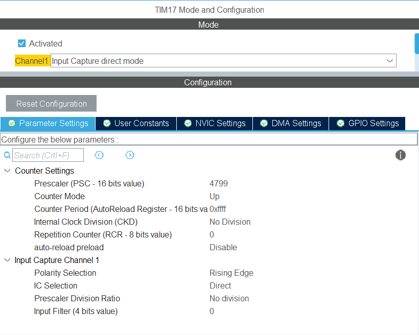

}Here is my setup for TIM17.

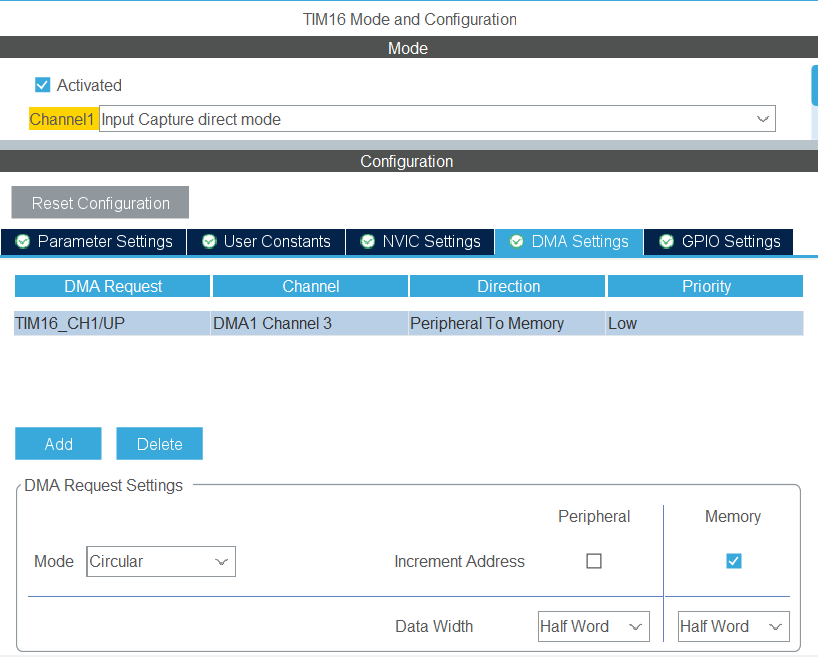

And here is for TIM16.
