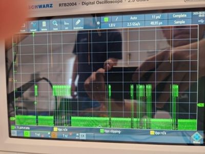

When proping using my osciliscope, I found that binary clock and frame clock works as expected operating at 8.192 MHz and 32kHz respectively. However, I also found that the SDATA seem to send more then one data frame, and that all the data is corrupted, or not looking like I expected. Below I took a image of the osciliscope readings, the green is the SDATA and the orange pulse is the frame clock.
So in short, the SDATA sends unexpected data, and I do not have any idea why. I have tried a lot of different things, and read the reference manual, but I can´t find any good explanation. Hope you can take time out to help me solve this.

SAI is not like SPI, waiting for data to generate clock. Rather, as soon as you enable it, it generate clocks inifintely, and if you don't feed it by data, it underflows but keeps transmitting, probably the last datum you wrote into.
I don't know what does the Cube/HAL function do, nor do I care - it's open source so you can look it up, or simply don't use it and write your own code doing what you want it to do.
Generally, there's little reason to use SAI without DMA feeding data continuously into it.
