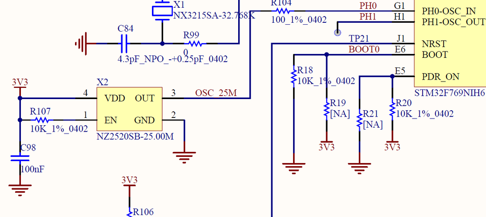

It seems like the HSE should be in bypass mode here based on the schematic.
However, the examples in CubeMX don't use it in bypass mode and I'm not sure why. The examples usually run correctly.
I would try HSE in bypass mode and see if that works.
