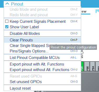

Another proposal when using STM32CubeMX with Board Selector: go to Pinout tab and click on "Clear Pinouts":

but as the LCD is ON, for instance, also if I change the features of the PINs, when I'm doing the connections the pins are always connected with the LCD pins and the outside. I was wondering if this can create interference. The answer of @Community member seems satisfatory, as I'm going to disable the chip via the chipset. Or are you suggesting that is enough to delete the features and add the new features?
