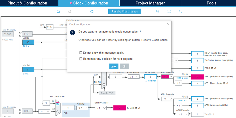

Is there a way to permanently disable the resolve clock issues feature of STM32CubeIDE-1.7.0? I've tried saying "No" and remember my options, but the interface just completely ignores me and does it anyway. It's utterly infuriating. Is there a preferences option somewhere I can set?
Is there a setting somewhere to disable this feature? It's frustrating as it keeps trashing my settings before I can fix them manually.
As it stands, it basically makes the .ioc view editor unusable. Since sometimes it just gets stuck updating clock frequencies even when you explicitly ask it not to, and it can very quickly ruin a configuration.

Same for me ! I couldn't reproduce your reported issue.
The only possible way to disable automatic clock issues solver is by clicking on "No" when this window pop up.
You can also check "Remember my decision for next projects" if you don't want CubeMX to solve your clock issues anymore.

Back to my original question however, is there a setting in the interface where I can disable automatic clock resolution?
Ideally I'd like a preference setting where I can disable it, since it's never useful to me.
I need to do a lot of fine control over my clock settings, and any nudging or changing that the interface does automatically is a disaster for me.

2021-09-01 1:25 AM
