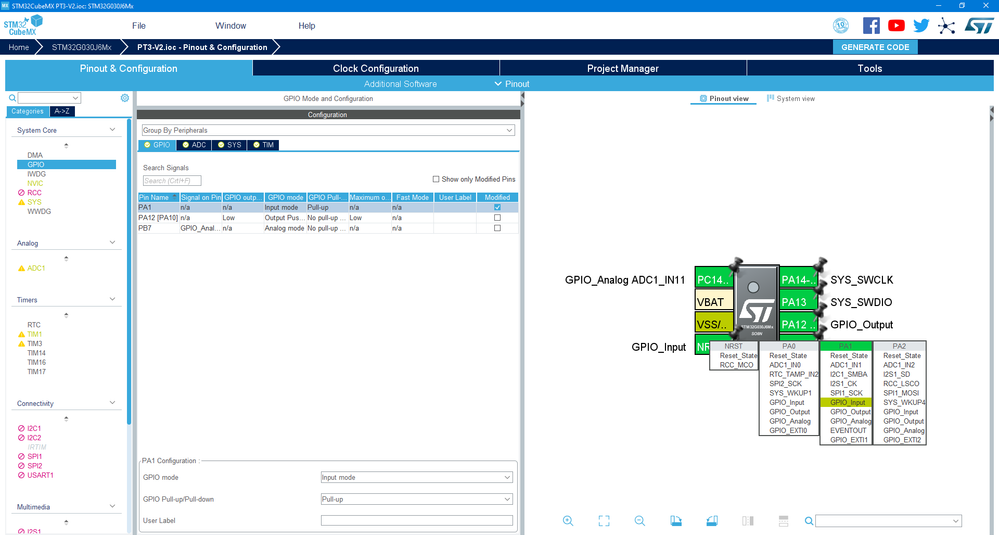

I have a design with a STM32G030J6 (SOIC8) controller. I don't need an external reset. I want to use the pin 4 as a GPIO (PA1). I connect a button to this input. I select the appropriate option in CubeMX, but when the button is clicked, the controller resets. How can I disable NRST from this pin?

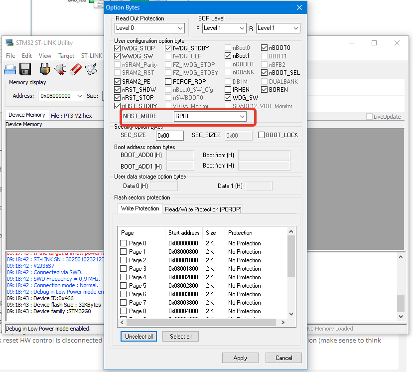

I was told that G0 family goes to small pincount packages and for example, BOOT pin is shared with SWDCLK, and Reset can turn as GPIO (like SWDCLK/IO if not debugging). Double or triple bonding is just short circuit multiple pads of the die to reduce package pincount In essence, we should focus only on RESET pin functionality. To my understanding, disabling RST to use it as GPIO requires to modify the option byte, which won't be set up by the source code, nor the bin file. You probably need to do something with cube programmer to access the option byte before you flash your code.
Also, in this case, make sure the STLink reset HW control is disconnected and configure it NOT to generate reset pulse when start debug session (make sense to think consequences of changes)
2020-07-09 11:20 PM
Thank you! This is true!

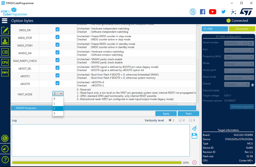

On the STM32CubeProgrammer you do it by selecting the option byte NRST_MODE and chose # 2 which is GPIO: standard GPIO functionality, only internal RESET possible wji

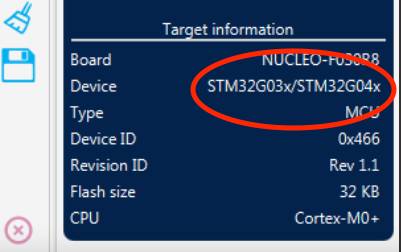

Looks like you're using STM32F030 whereas the OP is using STM32G030. They do not share the same option bytes.
2021-08-04 11:59 PM
You're mistaken.

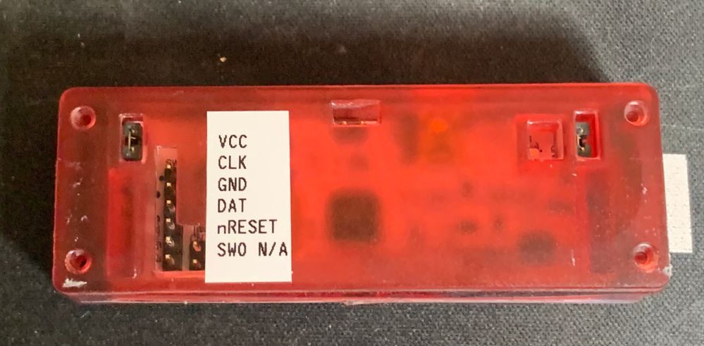

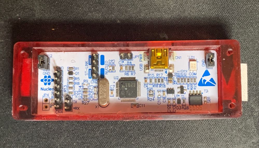

If you look at the screenshot that I posted in detail you will notice that the device is an STM32G03x series. What you see as a F030R4 "BOARD"is the identification of a nucleo STLINK section of that nucleo board. That line identifies the programmer not the target device. You can separate a nucleo STLINK programmer and make a standalone STLINK programmer with any nucleo that has one.
You can see how to do it here.
