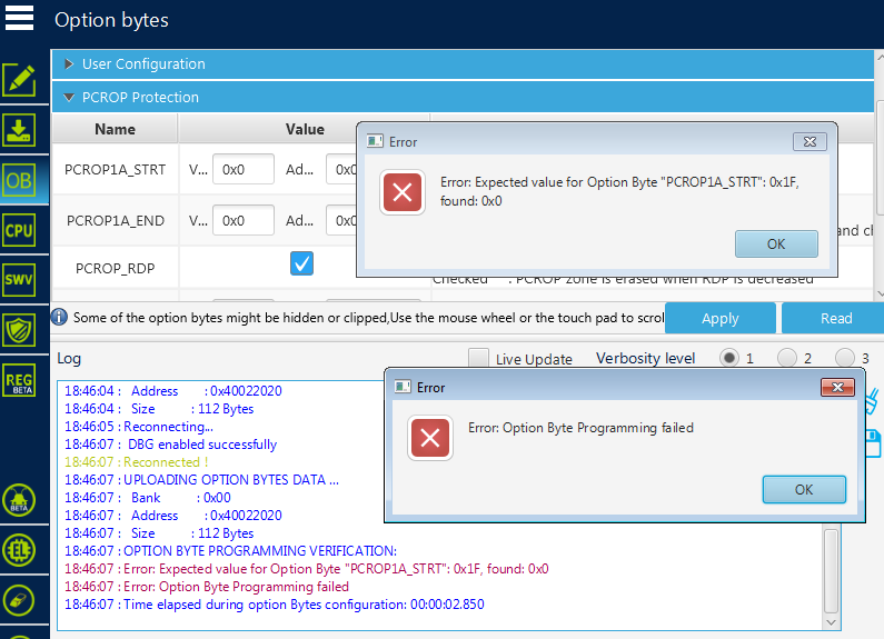

2023-01-18 9:49 AM
same issue with STM32CubeProgrammer.

2023-01-18 10:53 PM
What a pitty! All the nice CLI options to restore the option bytes are only available for STM32WL devices ???
STM32_Programmer_CLI.exe -c port=SWD -ob unlockchip

UPLOADING OPTION BYTES DATA ...
Bank : 0x00
Address : 0x40022020
██████████████████████████████████████████████████ 100%
Error: Only STM32WL devices are supported.
Error: Fail to unlock chip
STM32_Programmer_CLI.exe -c port=SWD -setdefaultob
STM32CubeProgrammer v2.12.0
ST-LINK SN : xxxxxxxxxxxxxxxxxxxxxxx
ST-LINK FW : V2J40M27
Board : NUCLEO-G071RB
Voltage : 3.21V
SWD freq : 4000 KHz
Connect mode: Normal
Reset mode : Software reset
Device ID : 0x460
Revision ID : Rev B
Device name : STM32G07x/STM32G08x
Flash size : 128 KBytes
Device type : MCU
Device CPU : Cortex-M0+
BL Version : 0xB2
Debug in Low Power mode enabled
Set default OB for STM32WL
2023-01-19 1:49 AM
Hello @Rena Z.,
I'll provide you a quick script to reset the Option bytes by software.
I'm quite surprising about the behavior you faced.
Best Regards,
Gwénolé
2023-01-19 2:24 AM
Hello @Rena Z. ,
To reset the PCROP1 you need also to perform a transition from RDP1 to RDP0.
So it means:
1-Check PCROP_RDP and put RDP=BB (level 1 reed protection)
2-Put RDP=AA (level 0, no protection)
3- Your PCROP registers have the default values.
Just be careful to not put the circuit as RDP level 2 otherwise the circuit will be blocked for ever.
Best regards,
Simon
2024-04-29 7:32 AM
I have a similar issue, can i have the script that put registers to default value ?
