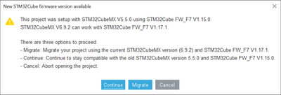

Hello @yuri CH
Once you open your ioc file, a window will pop up to indicate the version of MX used and the CubeFW version. Here is an example
I hope this helps!
