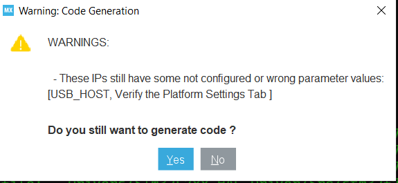

I want to setup my STM32F769 Discovery board as USB Host. I use STM32CubeMX :
Middleware-> USB_HOST-> Class For HS IP: Mass Storage Class.
But when I generate the code, it gave me pop up warning as following. What does this warning mean? And how should I resolve it?
2021-04-29 5:36 AM

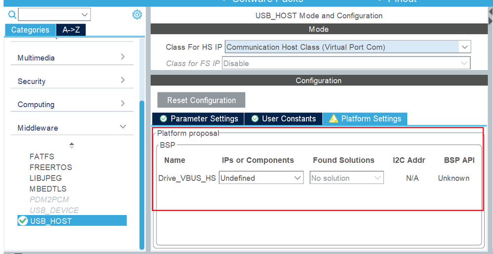

Hi @BParh.1 ,
Thank you for having reporting. Normally, as indicated by the warning message there is a missing configuration in the USB_HOST > Configuration panel > Platform Settings tab in STM3CubeMX:
Please complete the Drive_VBUS_HS configuration and try to re-generate the code.
Otherwise, when clicking the Yes button in displayed warning pop up, the project will be generated anyway.

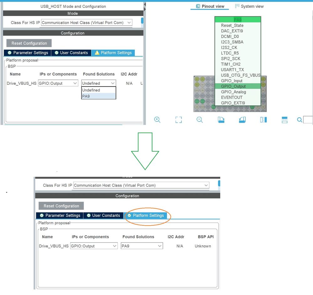

Hereafter screenshots showing an example, where I configured PA9 on a STM32F7 as a GPIO_Output:
Having a look at the generated code by CubeMX, once the Platform Settings are correctly configured, a file implementing the USB platform will be generated: usbh_platform.c
void MX_DriverVbusHS(uint8_t state)
uint8_t data = state;
/* USER CODE BEGIN PREPARE_GPIO_DATA_VBUS_HS */
if(state == 0)
/* Drive high Charge pump */
data = GPIO_PIN_SET;
else
/* Drive low Charge pump */
data = GPIO_PIN_RESET;
/* USER CODE END PREPARE_GPIO_DATA_VBUS_HS */
HAL_GPIO_WritePin(GPIOA,GPIO_PIN_9,(GPIO_PinState)data);
}If you click the Yes button in displayed warning pop up (without completing the platform settings), the project will be generated without any problems but the usbh_platform.c file will not be generated.
