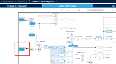

This is a screen shot of CubeMx starting a project from a board: NUCLEO-F767ZI.
Generated view starting a project from stand alone CubeMx:

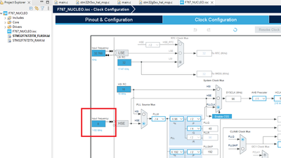

Generated view from CubeIDE (integrated CubeMx):

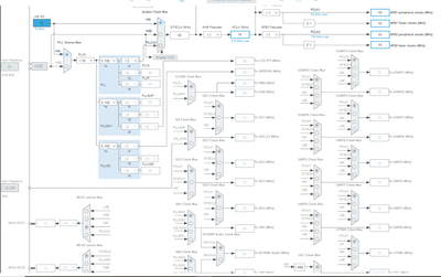

2024-09-27 6:19 AM
This is the screen of CubeMX for NUCLEO-F767ZI. Maybe it is not visible, but the number for HSE is 25

The above screenshots I shared respectively:
CubeMx 6.12.1 (stand alone)
CubeIDE 1.15.1

Your CubeMx has an old version.
For CubeIDE I didn't reproduce the behavior from my side, the clock is set at 8 as you can see from above.
