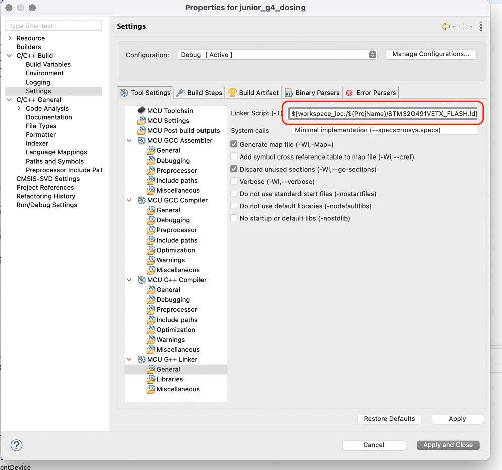

I would like to customize the linker script generated by CubeMX.
Right now, any changes to the linker file get overwritten when I generate code from CubeMX.
Is there a way I can accomplish this? Thanks!

You can rename the generated .ld file and specify the new file name in the linker settings. The renamed file should not be touched anymore.

2020-08-19 8:49 AM
Thanks @KnarfB that did the trick.

I cannot get this solution to work for my project. I have renamed the linker script AND moved it to a different folder (Core) but CubeIDE still overwrites it when I generate code.

in case anyone still wondering:
it's here:
