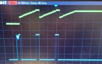

I am using timer 2 for trigger DAC and GPIO to generate analog and digital values.
own timer 2 started with DMA to change ARR by an array.
My GPIO array works well and starting to change from index 0 . but my DAC array start from Index 1.
as you can see, the longest pulse (200ms) in latest DAC value (dac[9] = 4000) instead of (dac[0] = 2000)

2024-04-19 2:03 AM
I have fixed.
1) start DAC DMA
2) htim2.Instance->EGR = 0x01; // trigged event by software
3) start GPIO DMA
4) start TIMER DMA
but why???
2024-04-19 12:07 AM
I think DAC Trigger Rising edge does not work, it starts on falling edge of TIM2-TRGO.
