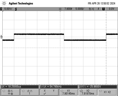

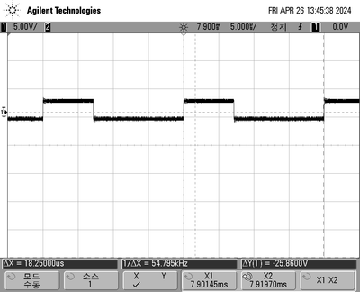

I'm using STM32H735VGT and ADC3.
There is too much time difference between converting 2 channels and 3 channels.
I want to know why converting 3 channels suddenly takes a lot of time.
And I want to know how to fix it.
Here are the scope photos and codes in each situation.
ADC3 , 2ch
static void MX_ADC3_Init(void)
/* USER CODE BEGIN ADC3_Init 0 */
/* USER CODE END ADC3_Init 0 */
ADC_ChannelConfTypeDef sConfig = {0};
/* USER CODE BEGIN ADC3_Init 1 */
/* USER CODE END ADC3_Init 1 */
/** Common config
hadc3.Instance = ADC3;
hadc3.Init.ClockPrescaler = ADC_CLOCK_ASYNC_DIV1;
hadc3.Init.Resolution = ADC_RESOLUTION_12B;
hadc3.Init.DataAlign = ADC3_DATAALIGN_RIGHT;
hadc3.Init.ScanConvMode = ADC_SCAN_ENABLE;
hadc3.Init.EOCSelection = ADC_EOC_SEQ_CONV;
hadc3.Init.LowPowerAutoWait = DISABLE;
hadc3.Init.ContinuousConvMode = ENABLE;
hadc3.Init.NbrOfConversion = 2;
hadc3.Init.DiscontinuousConvMode = DISABLE;
hadc3.Init.ExternalTrigConv = ADC_SOFTWARE_START;
hadc3.Init.ExternalTrigConvEdge = ADC_EXTERNALTRIGCONVEDGE_NONE;
hadc3.Init.DMAContinuousRequests = DISABLE;
hadc3.Init.SamplingMode = ADC_SAMPLING_MODE_NORMAL;
hadc3.Init.ConversionDataManagement = ADC_CONVERSIONDATA_DR;
hadc3.Init.Overrun = ADC_OVR_DATA_PRESERVED;
hadc3.Init.LeftBitShift = ADC_LEFTBITSHIFT_NONE;
hadc3.Init.OversamplingMode = ENABLE;
hadc3.Init.Oversampling.Ratio = 40;
hadc3.Init.Oversampling.RightBitShift = ADC_RIGHTBITSHIFT_NONE;
hadc3.Init.Oversampling.TriggeredMode = ADC_TRIGGEREDMODE_SINGLE_TRIGGER;
hadc3.Init.Oversampling.OversamplingStopReset = ADC_REGOVERSAMPLING_CONTINUED_MODE;
if (HAL_ADC_Init(&hadc3) != HAL_OK)
Error_Handler();
/** Configure Regular Channel
sConfig.Channel = ADC_CHANNEL_1;
sConfig.Rank = ADC_REGULAR_RANK_1;
sConfig.SamplingTime = ADC3_SAMPLETIME_2CYCLES_5;
sConfig.SingleDiff = ADC_SINGLE_ENDED;
sConfig.OffsetNumber = ADC_OFFSET_NONE;
sConfig.Offset = 0;
sConfig.OffsetSign = ADC3_OFFSET_SIGN_NEGATIVE;
if (HAL_ADC_ConfigChannel(&hadc3, &sConfig) != HAL_OK)
Error_Handler();
sConfig.Channel = ADC_CHANNEL_10;
sConfig.Rank = ADC_REGULAR_RANK_2;
Error_Handler();
/* USER CODE BEGIN ADC3_Init 2 */
/* USER CODE END ADC3_Init 2 */
ADC3 , 3ch
/** Common config
hadc3.Init.NbrOfConversion = 3;
Error_Handler();
sConfig.Channel = ADC_CHANNEL_0;
sConfig.Offset = 0;
Error_Handler();
Error_Handler();
sConfig.Rank = ADC_REGULAR_RANK_3;
Error_Handler();
And, Is there any fast channel??
Thank you.
