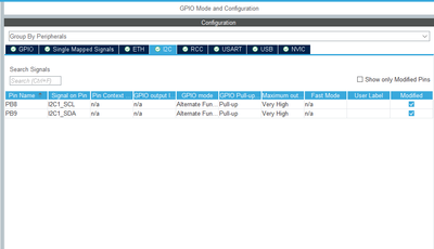

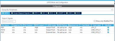

Sorry for the late reply @Sime200992 , but I was able to adapt the stm32h743ZI. Let me know if you have already completed this or need some assistance. I'd be happy to help!

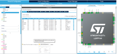

The image below showing I only configured 3 Pins. 2 for the i2c messages(SDA and SCL): PB8 and PB9. The other pin is incorrectly labeled, but it is the pin(if i recall ) to supply power: PB1.

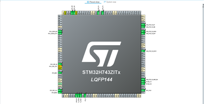

Here are a few other screenshots to help:

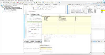

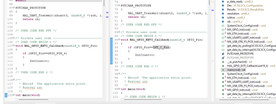

Thank you @Issamos  I'm currently referencing the build example for the F401RE(https://www.st.com/en/embedded-software/stsw-img023.html) , though I believe I've done the necessary changes  I see to be receiving a hard fault. Left is H7 and F4 is right. This has been the only change to the Main.c file and this is with H7 loaded default with the Tof F software pack.

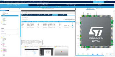

Yes @Issamos I began with configuration of the pins in CubeMX along with making the changes( The only real change was to the GPIO pin used and the USART pin used),without having to use any wires:

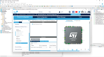

I also used the Software Pack  X-CUBE-TOF-1, Board Extension 53L5A1:
As you can see from the screenshot it seems to be failing
