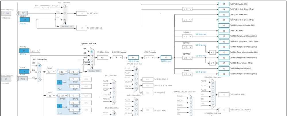

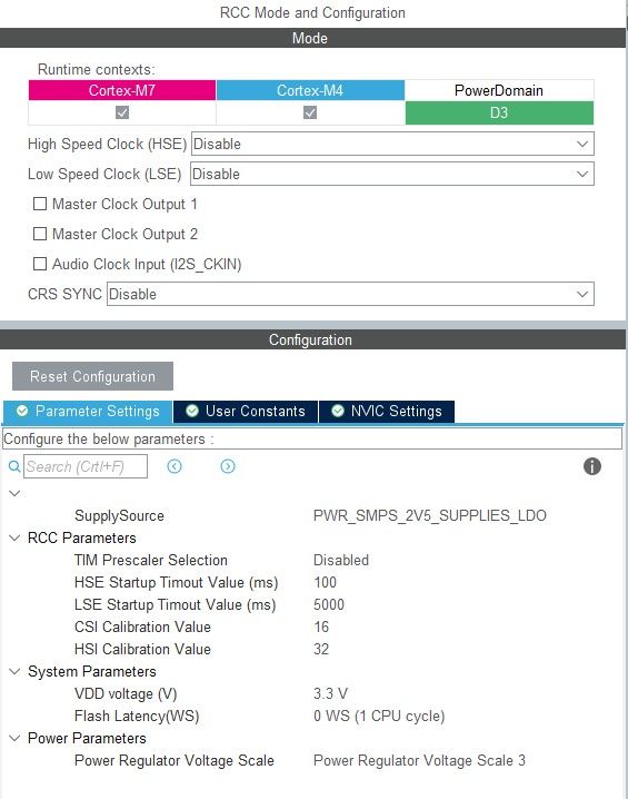

I've got a STM32H745BI on custom board and I cannot get it working. The program always jumps to the error handler at
while((__HAL_RCC_GET_FLAG(RCC_FLAG_D2CKRDY) != RESET) && (timeout-- > 0));
if ( timeout < 0 )
Error_Handler();
}I've found in the reference manual that D2CKRDY is D2 domain clocks ready flag, so it's probably some sort of clock issue. I'm using the internal oscillator. What could be wrong? Thanks :)
