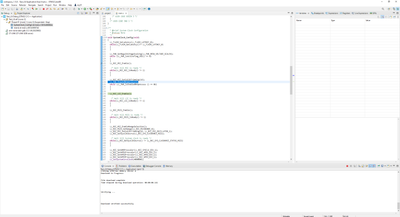

Hello @SOfne.1
Actually I tried to reproduce the issue mentioned above using STM32U575,CubeMX 6.9.0 and STM32CubeIDE 1.13.0 and this is what I got please have a look
"LL_PWR_EnableBkUpAccess()" does exist in the generated code.
Thx
Ghofrane

2023-07-26 1:56 AM
Hi Ghofrane,
the code you generated is OK.
Seems that the bug has already been fixed with STMCubeIDE 1.13.0.
(I currently use v1.12.0)
Thanks
