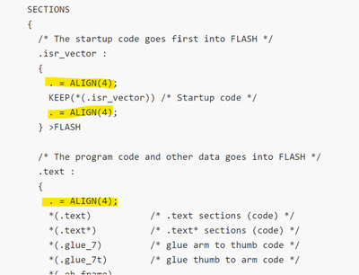

1. Whether to add ALIGN(4) even inside the FLASH sections present in STM32H753BITX_FLASH.ld (attached)

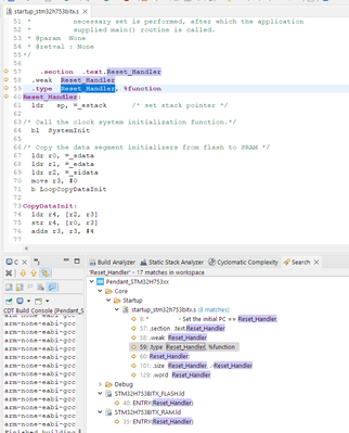

As you suggested I can either add code to file startup_stm32h753bitx.s (the one present on the right is the update):
Or alternately enable the macro DATA_IN_D2_SRAM present in file system_stm32h7xx.c (the one present on the right is the update):
I shall first try with updating the Code in above C file. If it does not work, then only I'll add the code to the above .S file.
Previous response:
I am compiling code using STM32CubeIDE and the code was generated using STM32CubeMX.
I only find below references for Reset_Handler. I do not find the line number 7 that is present in the snippet you shared. Which file should I look for the code snippet that you have shared?

1 > Whether to add ALIGN(4) even inside the FLASH sections present ..
yes, in all sections.

Since answer to my first query is Yes, I believe the default STM32H753BITX_FLASH.ld file provided/added by ST should be updated to include the ALIGN(4) in all sections (especially in the FLASH sections). I would request ST / Khouloud (and her team) to update STM32CubeIDE so that the updated file is available when user generates the code.
The linker script already has alignment to 32-bit words.

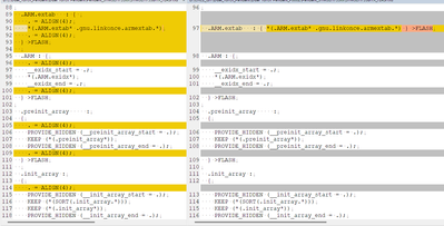

I observe below when comparing the file that my team uses (on left) and the one that STM32CubeMX generated (on the right):
Regards,

2024-02-11 11:01 AM
; Reset handler
Reset_Handler PROC
EXPORT Reset_Handler [WEAK]
IMPORT SystemInit
IMPORT __main
LDR R0, =0x580244DC ; Enable D2SRAM clocks in RCC_AHB2ENR
LDR R1, [R0]
ORR R1, #0xE0000000
STR R1, [R0]
LDR R0, =SystemInit
BLX R0
LDR R0, =__main
BX R0
ENDP ; Reset_Handler
