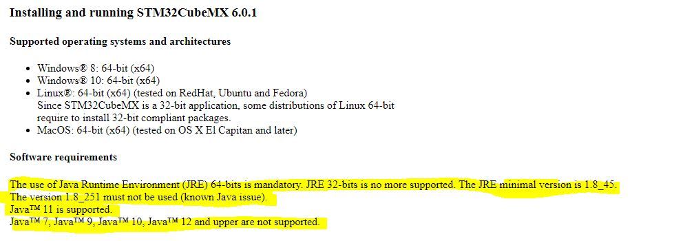

Hello All,
I faced the same issue and I solved my problem on my own.
You guys might be facing the issue due to same reason.
Please Follow these steps.
4. After matching the java version, please restart the PC(This is important).
5 Still doesn't work ? Uninstall completely including program data and settings and follow the above steps.
Kind Regards
