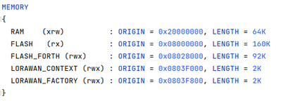

So, I am setting up linker script as @Andrew Larkin suggested and going to use an external tool to populate the Flash.

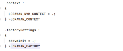

linker script; I removed the #define and replaced it with a "extern" declaration. Not ideal, I know.

Nice overview! And yes, I have defined 0x0803f000 and 0x0803f800 as two regions in the linker script, and removed the seNvmInit declaration i soft-se.c, and removed LORAWAN_NVM_BASE_ADDRESS and introduced LORAWAN_NVM_CONTEXT, which (with the definitions below) is a variable (declared as an array will get the address when used).

On the second point of the factory settings, the code already tags the seNvmInit with the USER_embedded_Keys segment, so I think the cleaner way to handle this is to locate the segment where you need it.
This solution also remains "clean" to code regeneration.
I chose a different memory arrangement in the ld linker script as follows:
/* Memories definition */
MEMORY
RAM (xrw) : ORIGIN = 0x20000000, LENGTH = 64K
RAM2 (xrw) : ORIGIN = 0x10000000, LENGTH = 32K
FLASH (rx) : ORIGIN = 0x08000000, LENGTH = 250K
LORAWAN_FACTORY (rx) : ORIGIN = 0x0803E800, LENGTH = 2K
LORAWAN_CONTEXT (rx) : ORIGIN = 0x0803F000, LENGTH = 4K
