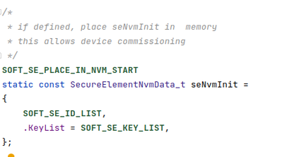

So in soft-ce.c there is this little hint;
Which seems to suggest that "Yes, you are supposed use external tools directly to populate Flash memory locations.", and that we would need to work out where the important bits will end, how to compute the CRC...
I think I am going to replace soft-ce.c with my own implementation, so I know what is going on.

I'm not actually seeing anything to indicate that the context in flash has a valid CRC - shows as zero. As this data is being initialised by declaration in the source code, it would need the developer to compute a CRC and add it:
SOFT_SE_PLACE_IN_NVM_START
static const SecureElementNvmData_t seNvmInit =
SOFT_SE_ID_LIST,
.KeyList = SOFT_SE_KEY_LIST,
.Crc32 = 0x11223344
With the USER_embedded_Keys mapped as I described before (0x0803e000), I get the following addresses for the keys of interest:
DevEUI[8]: 0x803e000
JoiEUI[8]: 0x803e008
APP_KEY[16]: 0x803e019
NWK_KEY[16]: 0x803e02a
