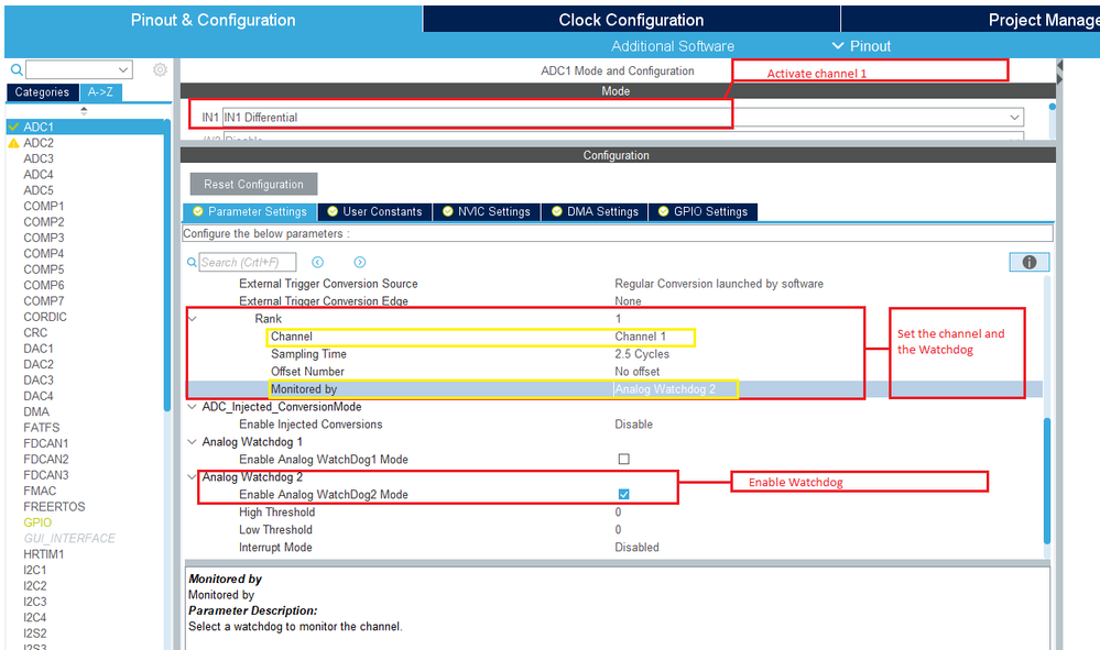

CubeMX shows no option for setting the active channels for analog watchdog 2 and 3 for the STM32G474RBTx.

Hello LDoes.1,
STM32CubeMX has already this option, in fact, in order to select a watchdog (2 or 3) to monitor a channel (e.g., Analog watchdog 2 to monitor channel 1) :
You’ll find below a screenshot to clarify more the process (case channel 1 activated and Analog Watchdog2 enabled).
BR,
Khouloud.

Hello LDoes.1,
BR,
Khouloud.
