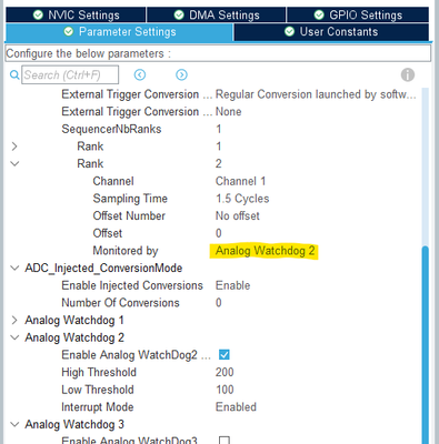

The first watchdog successfully generates

}The second watchdog generates... nothing. When I write out similar code myself for the second watchdog then it starts working. The IOC interface looks like

Did you enable it?

2025-10-03 6:42 AM
Thanks very much; that was the issue. I didn't see that "rank" can expand.
