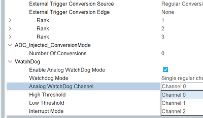

When I try to select which channel gets a watchdog, it only gives me one option on the pull down. Instead, if I want to change the channel, I have to unselect all the ADC channels and make sure that the watchdog intended channel is the first one selected. Is this normal?
From the photo above, only one channel is always available in the pull down.

You're only converting a single channel as only "Rank 1" appears in your screenshot. If you add additional conversion ranks for different channels, they will show up as an option. Change Number of Conversions to whatever and configure each rank to a channel.
If you still can't get it, include your IOC file.
