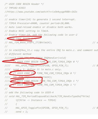

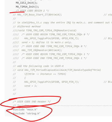

The main.c file you have attached contains many "/* USER CODE" texts within USER CODE blocks.
It also includes several duplicate definitions, including two of main() where the first one is unfinished. It definitely does not compile.
Perhaps edit your file so "USER CODE" is not used anywhere within the user code sections.
When I edit your file to correct the above errors, it compiles. If I edit the IOC and regenerate code, it does not duplicate sections.

2024-09-02 5:53 PM
Don't add the text "/* USER CODE" within your USER CODE sections.
