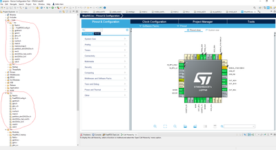

2024-11-18 4:54 PM - edited 2024-11-18 4:57 PM
Hi Mahmoud,
Thank you for your reply. These source folders (Src and Inc) existed when I first generated the projects and then they won't be updated after each consequent code generation. This is my secure project where you can see the duplication as shown below
If these files are not updated after each code generation, Can I remove them and put all my project code under Core folder?
