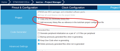

"When you uncheck “Use Default Firmware Location,” the IDE references the libraries as external links instead of copying them," - This is not correct, there is another thing for this function. The options you are referring to are the ones here in the screenshot:
“Use Default Firmware Location” will allow you to get the library from another CubeMX FW installation. But this, unfortunately does not work with github repository of the library.
