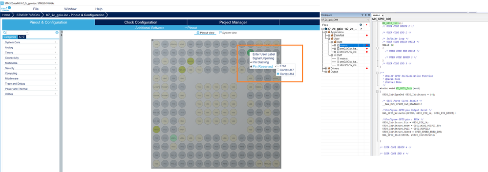

you need to make a "right" click on pin and you will find the Pin Reserved option as bellow:

So you need to specify in which context you need this pin.
Right click on pin then under "Pin Reserved" Choose one of the 2 Cortex.
2019-10-02 12:31 PM
Thank you. It worked. Do you have FreeRTOS port or ST library or any recommended method example code for communication between M7 and M4 cores on this SoC?
