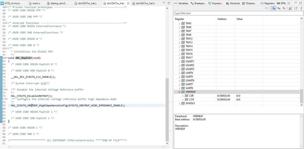

CubeMX generated code missing clock enable command before VREFBUF configuration.

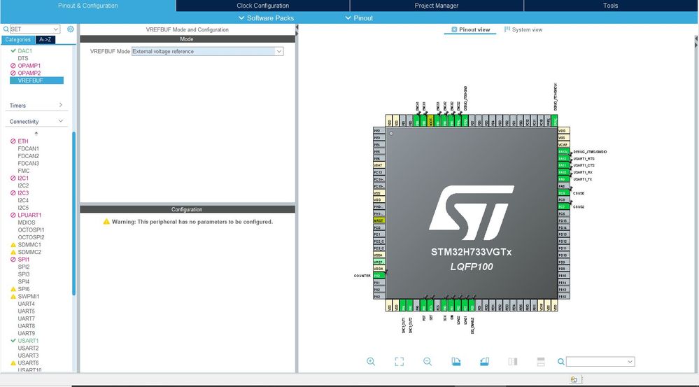

cube configuration:
Generated code:missing "__HAL_RCC_VREF_CLK_ENABLE()" prevents any configuration...
