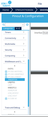

Can't answer you question as I am new to theadx. I am just curious what MCU do you use? I don't seem to have option to enable threadx for F4/F7/H7.

2025-03-30 4:18 PM
H743
2025-03-30 4:28 PM
Interesting, I don't have threadx option for H743...
2025-03-30 4:41 PM
you have to install the software pack first by clicking on "Software packs"
the select the options you want under azrtos
2025-03-30 5:31 PM
Ah, thanks a lot! You saved me a lot of time. Appreciated!
