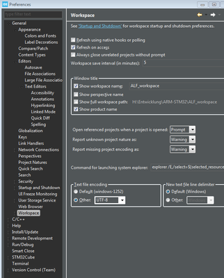

2025-04-02 6:34 AM - edited 2025-04-02 6:34 AM
afaik this has not much to do with the CubeMx version, but with the IDE version and especially its settings:
...so try:
- but there might be other definitions in the settings and preferences...just look. :)
