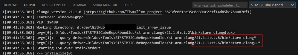

could you check what STM32Cube clangd outputs under “OUTPUT” when you run it?
After opening the project in VSCode and opening the first source file, I get this:

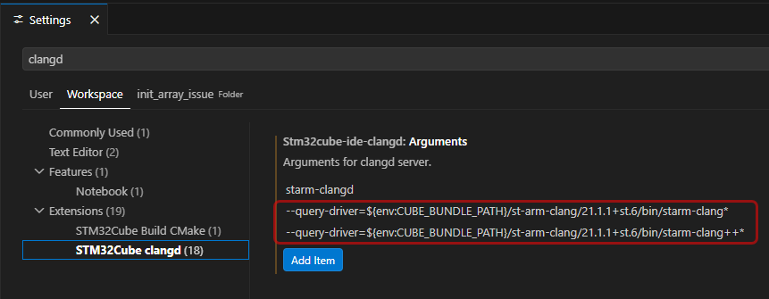

If you see here old versions, please check the VSCode settings:
(Depending on whether you're using a workspace file, the storage location varies: Workspace, or project folder.)
To get the correct path here, simply delete the two entries (preferably in the JSON view), save the file, close VSCode, and reopen it. The latest entry should now be used.
