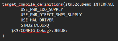

It is defining both USE_PWR_LDO_SUPPLY and USE_PWR_DIRECT_SMPS_SUPPLY in the generated CMake file. It should only define USE_PWR_DIRECT_SMPS_SUPPLY since that's the selected power mode in CubeMX. I believe this is just a bug with STM32CubeMX code generation.

If I bump your SYSCLK to 280 MHz (max value) the generated CMakeList.txt file only contains:
target_compile_definitions(stm32cubemx INTERFACE
USE_HAL_DRIVER
STM32H7B3xxQ
$<$<CONFIG:Debug>:DEBUG>
)It is confusing how and what the different options are.

That's very interesting. On my original project I ran into this issue, I have the clock set to 280 MHz. I can't share that IOC file unfortunately, but it seems like there's a bunch of things happening in the background that may effect this issue.

@Ghofrane GSOURI is ST aware of the issue I mentioned (CubeMX creating multiple different USE_PWR* definitions) so that it may be fixed in a future version of STM32CubeMX?
2024-12-05 1:11 AM
Hello @cvanbeek
I Couldn't reproduce the issue with a new project starting from scratch but a ticket has been raised to dev team for further investigation to identify the root cause of this behavior (internal ticket number 197797 )
THX
Ghofrane

Hi @Ghofrane GSOURI,
Thank you for noting the issue. Here's more info on my environment and the example I generated with this issue.
Environment:
Steps to generate a project with the error:
The resulting cmake/stm32cubemx/CMakeList.txt file has the incorrect USE_PWR_LDO_SUPPLY definition:
