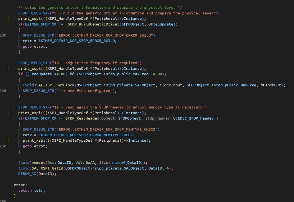

I have added the EXTMEMSALXSPIDEBUGLEVEL macro and printed the registers for XSPI2 in steps 9, 10 and 11
The location of the print is shown below.
The log as follow:

SFDP::11 - read again the SFDP header to adjust memory type if necessary
XSPI Configuration start
XSPI Instance: 0x5200a000
CR = 0x00000001
DCR1 = 0x01190300
DCR2 = 0x00000002
DCR3 = 0x00000000
DCR4 = 0x00000000
SR = 0x00000004
FCR = 0x00000000
DLR = 0x00000017
AR = 0x000000E8
DR = 0x00000000
PSMKR = 0x00000000
PSMAR = 0x00000000
PIR = 0x00000000
CCR = 0x00000001
TCR = 0x10000000
IR = 0x000000B7
ABR = 0x00000000
LPTR = 0x00000000
WPCCR = 0x00000000
WPTCR = 0x00000000
WPIR = 0x00000000
WPABR = 0x00000000
WCCR = 0x00000000
WTCR = 0x00000000
WIR = 0x00000000
WABR = 0x00000000
HLCR = 0x00000000
CALFCR = 0x00120047
CALMR = 0x00000000
CALSOR = 0x00120011
CALSIR = 0x00120011
XSPI Configuration end
SFDP::SFDP_ReadHeader
SFDP::SFDP signature::0x0
SFDP::signature of the header: KO
SFDP::ERROR::EXTMEM_DRIVER_NOR_SFDP_MEMTYPE_CHECK

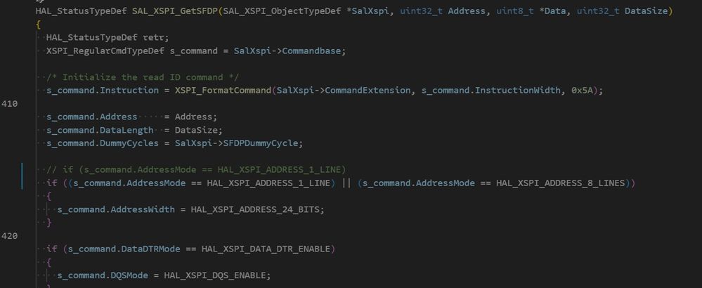

On the second reading of the SFDP signature (step 11), we can see that the memory has been configured in 1S8S8S mode.
By checking the XSPI register, we found the following:
According to the memory datasheet, the READ SFDP command is only described for standard SPI and octal DDR modes.
Could you try modifying the following line in the function
SAL_XSPI_GetSFDP(SAL_XSPI_ObjectTypeDef *SalXspi, uint32_t Address, uint8_t *Data, uint32_t DataSize)
if (s_command.AddressMode == HAL_XSPI_ADDRESS_1_LINE)
to
if ((s_command.AddressMode == HAL_XSPI_ADDRESS_1_LINE) || (s_command.AddressMode == HAL_XSPI_ADDRESS_8_LINES))
Kind regards,
2025-08-20 10:01 AM
It has been modified to what you said, and there are errors.

Could you please comment out the second reading of the SFDP signature in the EMM driver, as well as the second reading of the ID ?
Kind regards
2025-08-24 9:13 AM
Comment out the second reading of the SFDP signature and the ID in the EMM driver, still can't jump to the app.

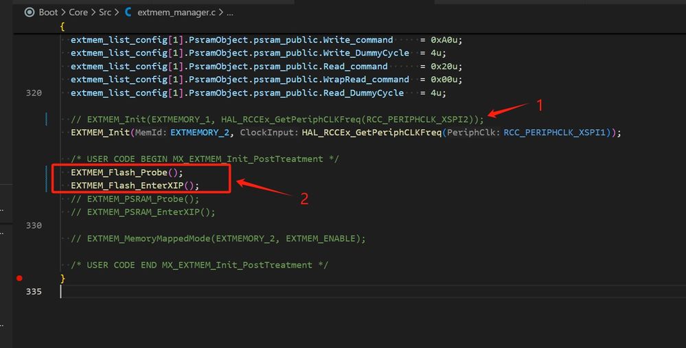

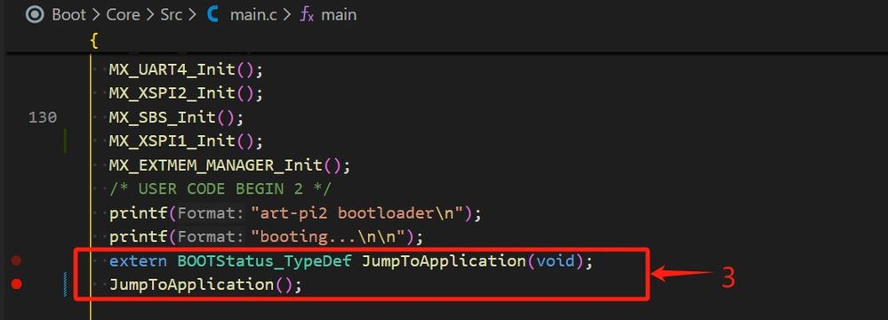

EXTMEM_GetMapAddressI transplanted this flash program from somewhere else, into mapping mode.
There are several modifications.
Read Flash ID success:0xef 0x5b 0x1a
Reconfigure Flash clock
Flash Re-Enter Octal DTR and Read ID success:ef 1a 00
Flash XIP success
art-pi2 bootloader
booting...
[info application]Hello main!
Although it is available now, I would like to figure out if there is a bug in the middleware of the STM32_ExtMem_Manager.
