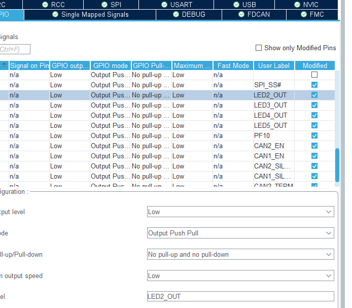

This is the state before code generation.
User labels are well reflected here

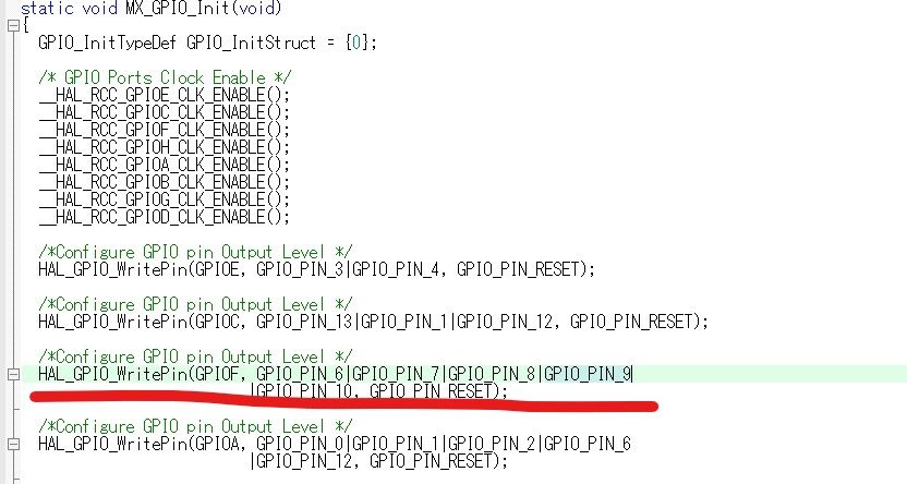

After generating the code, let's take a look at uVision.
The user label has come off.

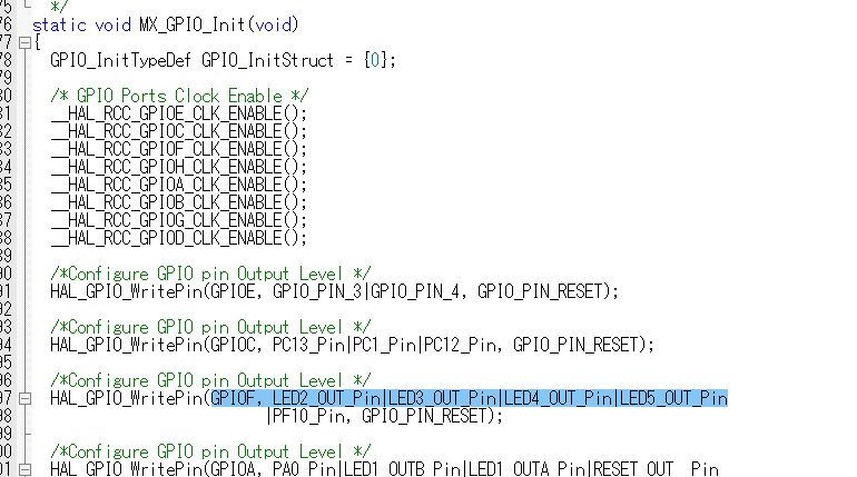

This is an old project, but it reflects the user label.

The newly created project did not have this issue.
The user label was correctly reflected in MX_GPIO_Init.
