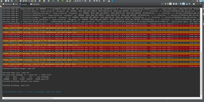

Then i tried to open that network window... but before that a small window opened which showed configuring usart3 and it got stuck at 70% for very long time... i tried closing the app and disconnecting, restarting pc... but the same thing is happening... i shared a screenshot of where it got stuck...

There are soo many errors and warnings...

C:/ST/STM32CubeIDE_1.18.0/STM32CubeIDE/plugins/com.st.stm32cube.ide.mcu.externaltools.gnu-tools-for-stm32.13.3.rel1.win32_1.0.0.202411081344/tools/bin/../lib/gcc/arm-none-eabi/13.3.1/../../../../arm-none-eabi/bin/ld.exe: C:/ST/STM32CubeIDE_1.18.0/STM32CubeIDE/plugins/com.st.stm32cube.ide.mcu.externaltools.gnu-tools-for-stm32.13.3.rel1.win32_1.0.0.202411081344/tools/bin/../lib/gcc/arm-none-eabi/13.3.1/../../../../arm-none-eabi/lib/thumb/v7e-m+dp/hard\libc_nano.a(libc_a-signalr.o): note: the message above does not take linker garbage collection into account
see i am getting this error... how many times ever i tried to build
